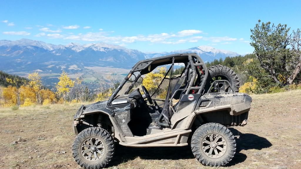

I have the STI Hd 5 beadlock wheels 14x7 with 5+2 offset and I am very happy with the look I will try and get a pic in the next day or so.
