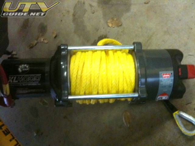

Stock Commander XT comes with this mess:
I contacted Custom Splice and ordered up 1/4" x 50 (yellow rope of course) AmSteel Blue. The new rope has 8600 lbs breaking strength. Also got a 6 inch 6061 aluminum fairlead, with black hard coat anodize so I could ditch the old roller.
The installation was pretty simple, but very time consuming (maybe 1 1/2 hours). Not because the rope was hard to work with, but just because Can-Am uses allen head bolts that are very hard to do much with. It is a time-consuming process to spin four bolts out when you can only get about 1/8 of a turn out of each movement.
I do need to pull the rope all the way out and back in to line it up nicer on the winch, but it all fits well.

On my XT winch I took off the cable an put on the Can Am synthetic rope. It is lighter and won't cut your hand up if you don't have gloves on. I also got a 50' extension synthetic rope to boot (kept in my tool bag). It only took me about 15 minutes to put in.
I didn't have to take apart anything, just unwind the old cable pull out the end, put the end of the new synthetic rope in the hole and hooked the other end to the hitch of my truck and wound it up by using the winch motor to pull the Commander to the truck.
